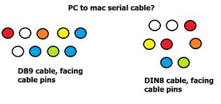

I bought a cable on ebay blindly, it was cheap, and the wiring doesn't look promising. this is the diagram of how the pins are linked together on both ends of the cable

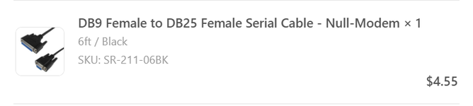

So I bought these and they are on the way:

RXD+ on the Mac side probably needs be grounded so that it is not floating and the difference between RXD+ and RXD- is sufficient for a proper signal (RS-422 uses differential signaling).
If HSKo is connected to DSR then HSKi just needs to be DTR but you have it set to DCD, CTS, and RTS.
DCD and CTS are inputs but RTS is an output. I don't know if it makes sense to tie them altogether.
Well, if the app doesn't require flow control then maybe it doesn't matter.
