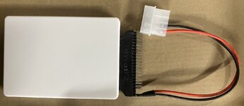

Either way, here's a look at the IDE stuff:

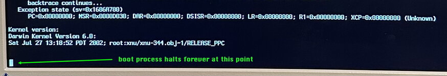

When I try to install a fresh 10.2.8 onto the SATA-SSD with the help of XPostFacto and its default settings, the reboot process of the installation also seems to stop at the same point, but as the console prints throughout the whole boot process, it carries probably some more details. Therefore I added commented screenshots of the latter process.
... screenshot continued...
I suspect, that the term "OpenOldWorldNVRAM: Saved New World NVRAM partition at 0 is too long" might be the problem. But I have no idea, what this means or how to come across this. (Not sure, if this is really the problem, as in the working boot process from SCSI HD, without SATA controller, booting does not show console lines)

The backtrace via exception chain seems to indicate an infinite recursion problem - all the addresses are 0x219edc.

Your issue doesn't look like a kernel panic though since there's no kext information.
