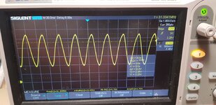

Hi David,

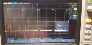

The OE of each ROM chip (pin24) all have the same 156.68kHz square pulse of 890nS pulse width and Pk-Pk of about 5.32v

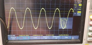

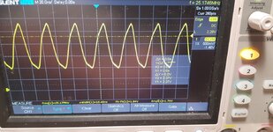

G1 has a sinusoidal output of 25.17MHz Pk-Pk 1.84v
G2 has a much cleaner sinusoidal output of 31.35MHz Pk-Pk 1.76v
Y1 has a sinusoidal output of 32.76kHz Pk-Pk 1.0v

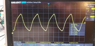

Pin6 of CPU, measured at pin B7 of the processor direct socket gives 15.67MHz, Pk-Pk 3.56v
The screen is a single colour, a grey/white colour. There is no checkers or lines, just a solid single colour over the entire screen. The monitor says it detects a 640x480 signal.

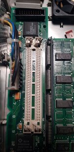

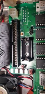

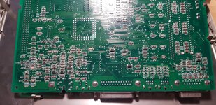

Can I see some photos of your board please?
Hi joshc,
I've attached some photos, let me know if there are any important areas you need images of.

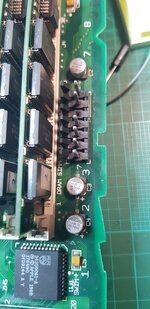

Hum. Those photos do show signs of cap leakage. See how the solder in a number of areas is dull grey? That is due to corrosion. A perfect condition board has shiny silver on all of the pads.
Pay attention to the areas around U10 and UA10.

Those signals all look good. Okay, so you've got a solid clock and the ROM is being accessed. No sound. No video.
If the LC II has entered diagnostic mode, that would help you eliminate some of the causes. See this link for details.
Basically, if any startup ROM test fails, the Mac enters a serial state where it accepts commands and outputs results at 9600 baud. Let's say you have a terminal program running on a working computer which is connected to the LC II. In the terminal program you type *V and the LC II should respond with version information. If that works, you know the LC II ROMs and CPU are at least partially working. From there, you can run various tests to maybe spot the problem.

Hi,
Last time I had this exact problem was a bad connection on one of the ground pin of U10 preventing a proper RESET on all ICs. Sadly, I can't recall which one.
Could you share an equivalent picture to the second photo, but after the recap?

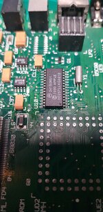

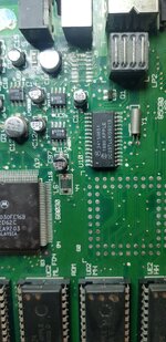

Hi Phipli,
I've never actually seen cap leakage firsthand, but I do see the effect it has on the board. I've seen old PCB solder tarnish after years of oxidation and assumed that was the case here.
You will see a small red fly-wire connecting the +ve of C19 (47uF) to a via. Unfortunately the +ve pad partially lifted from the PCB when I was desoldering the cap. I did note the fibreglass under the pad was a strange black colour, so I alcohol swabbed it down before putting a small drop of superglue under it. The track to that pad was under the component but still electrically intact, so I fly-wired it just in case.
Is the black fibreglass indicative of cap leakage ??
I have retouched some of the vias that were looking hollow and empty with some fresh solder.
Should I electrically check continuity for each via through the board ?
Or should I neutralise the cap leakage ? I have gently cleaned the board with IPA and cotton buds / toothbrush after decapping.
Any thoughts ?

Something to check is that there aren't any shorted vias under tantalum caps. I tend to take a photo after I initially remove all the caps so I can reference where the vias were afterwards. The tantalum have wider pads than electrolytics, so there can be issues. If you look at my boards you'll sometimes see one capacitor offset in a row, it isn't because I was drunk, I was just avoiding a via, honest.
WfRT cleaning, if possible I'd give it a bath in a tray of IPA, perhaps scrub with a toothbrush, especially in the area discussed.
Pads seem to lift more easily after cap leakage.
