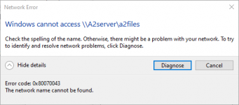

I am not using a Pi. I am using a VM for the A2SERVER.
I can ping the A2SERVER VM just fine.
This is what I see in Network and trying to double click on A2FILES gives the error I posted no matter what I do, rendering A2SERVER useless as I can not get files on to it even tho it works fine on the Mac end:
Perhaps a problem with the VM? I never heared this for a raspberry pi.
Are you logged in in windows as an administrator?
To clarify, the intended use of the "A2FILES" Samba share is to upload files that are then to be accessed by the A2FILES Appletalk share on the Mac side of things correct ?
This is correct. Something else you could try is to use SFTP to access the share from a modern machine instead of Samba. To rule out possible problems with the VM, I would recommend trying again with your Raspberry Pi.
