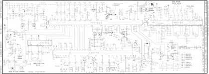

my guess the eject happens automatic if the SWIM got a reset-signal(?) or the command and the floppydrive-IC then trigger the eject-motor according to the sony schematic.
but something strange is at the Pin 9 eject-Pin, which isnt connected inside newer macintosh anywhere, but on the older its connected to a ferrit and a cap (like mac II) but my II upgraded FDHD have a cutout in the floppycable?

Looks like the Ejectsignal on Pin9 is intended to use in a external Unidisk Chassis (with a Button wired to the Ejectpin), that was included in later Version of the Sony 800k Drive and FDHD.
The "macintosh software" Eject seems to be hardwired into the FDD-Controller that trigger the internal EJECT-signal to the transistor (CA1 & CA0 & SEL0 & LSTRB(100ms strobe?)).
Maybe useful if anybody has a faulty drive with eject.
