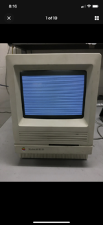

I own a second SE/30 in working condition which I took to test my recapped logic board. And indeed, it is "working" in a sense that it produces the "Horizontal stripes" symptom.

Can you take a photo of the actual symptoms/simasimac pattern your SE/30 produces?

Mine had the same screen before recap, and sometimes after recap. My classic did this too. I believe it is ram related as both times I cleaned memory area really well and now have zero issues. On the se/30 i checked for any corrosion or dullness on simm sockets fingers where it touches memory stick. I purchased my se/30 with that exact screen for parts/ repair.. works excellent today
