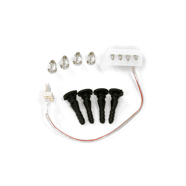

Speaking of silence, I've followed JDW's advice and got a silenx ixp-34-16 on the way to replace the stock noisy fan (http://www.silenx.com/quiet.fans.asp?sku=ixp-34-16).

Have received the IXP-34-16 60mm silenx fan. Man this thing is silent, but I agree with JDW, it doesn't feel as though it moves as much air as the OEM fan (supposedly 18cfm vs 19cfm flow respectively), but it's not yet in the cage, so we'll see - perhaps that'll boost it a bit. It's a very easy hook up - it comes with a molex in-line plug (http://www.silenx.com/l.ixp-connectors.jpg) so it can be powered directly off the existing hard drive molex lead (and only draws 0.34 watts, so should be fine on the 12V line@ 0.028Amps). It's just a matter of desoldering the old fan's power leads from the analog board, which means the board can easily be returned to the stock fan in future if needs be as no wires need to be cut.
