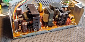

One of my SE/30s is getting its motherboard recapped and this is what is PSU looks like with leaky goo:

Given this planned configuration, would you recommend getting the PS recapped or heading down the path of hacking in an ATX power supply? FWIW, reecapping is not in my skill set but I think I could follow along to do the ATX if it is just soldering some wires.

I have pretty much the same setup minus the video card which I'll hopefully install on top of the Ethernet card someday. My PSU was recapped and everything's fine as far as I can tell.
I'd say recap it, and if you experience any problems in the long term, you can still sell it and make a profit.

My current supply does work, but a due diligence recap is a definite. There may be a replacement down the line. I think a recap now would be more economical (for me personally). (<$20 for parts vs >$50 for a Sony psu and parts —a rough estimate, as of this morning).
And I don't have anything going into it beyond a scsi2sd, macsimm, and 32meg of RAM, currently.
This might change when/if I manage to track down a PowerCache or a DiiMo, but that's not an immediate future goalpost. And by that point I'll probably just go the seasonic route, barring its discontinuation and larger price hike.

I'm late, but is there possibly a third type of power supply? I picked up what looks like a standard SE/30 with a beige power receptacle and switch, but the power supply (with leaking caps) is marked as follows:
Inner case - APPLE COMPUTER 805-0945-01 MADE IN SINGAPORE
PCB front - APPLE COMPUTER S'PORE PTE LTD
PCB rear - 820-0385-A
The recap parts list for both Sony and Astec supplies do not align, and there are numerous small capacitors on the board.
I'm assuming I'll either have to track down the 17 electrolytic cap part numbers and do a recap, replace with a used unit, or adapt a modern supply into the case.

The general location of most of the capacitors is quite similar to the Sony, and even the big 620uF matches. But I do see the layout differences.
Would you mind making a detailed list of all the caps on your PSU, noting the silkscreen markings like C1, C2, etc., as well as noting the voltage and capacitance on each electrolytic cap?  Also, if you have calipers or a metric ruler, noting the spacing between the two feet of each cap is useful too, to ensure replacements fit properly.
Lastly, I see the green solder mask is partly coming off on the bottom of your board.  You should replace that with new UV solder mask like this when you recap. You can cure it in sunlight. Just be sure to carefully scrap off al the old bubbled soldermask first.
