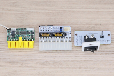

I'm going with the Pico +adapter in the top link version, about to send a 160w pico to the person refurbing my brother's SE 30. It too has had a complete recap and is heavily expanded : 50 Mhz Diimo 030 accelerator and a network card. I have a 120w power brick, the original sony PSU is 100w.
Soo Will let you know how it goes. I got the adapter before the pico so yeah....
- Action retro puts one in a very beefed up SE30...
I must admit I am biased on this topic, but one of the issues I see with the Pico kit is that it relies on a DC barrel jack for the power input. These are usually rated for 5A max. I’ve seen a few from Switchcraft that are rated for 7.5A, but they are $.
With a 12V input at 5A, that gives a max power of 60W, which comes substantially short of meeting the original PSU specification.
Perhaps the folks at PicoPSU have sourced a high current barrel jack, but even so, you would want a jack rated for 8A+ to meet a 100W power requirement.

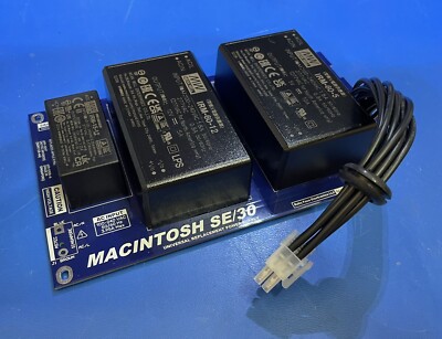

You bet. A number of manufacturers have PCB mount power supply modules. I have preference for Mean Well as they have never let me down and have an intersection of price and quality that’s hard to beat.

I remember looking at that model for a single supply replacement, but its 12V output comes up short for meeting the original current specification. I decided to substantially over spec the output currents to meet needs of those who expand their system.
