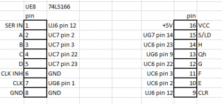

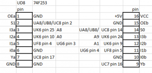

I triple checked and booted with another board OK. Moved its ROM and RAM to this board but get the same result. Slow chimes. Does replacing the F258's next make sense?
Check all signals on the RAM sockets and trace them to their destination.
Often you get broken traces around the resistor network next to C1.
The RAS and CAS lines run through there - if one of those is broken you will get slow chimes.
