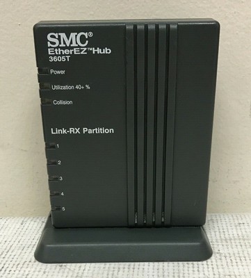

These responses are really helpful. Regarding the hub, would something like this be a possibility?:
SMC EtherEZ Hub 5-Port 10BASE-T Ethernet Hub 3605T

I have a 10 base t hub coming. So I may set this aside until it arrives unless there are some ideas from this group.

Success!! @robin-fo 's guidance regarding the 10base t hub did it. I was able to daisy chain the hub off of my existing gigabit hub and things started showing up. Also, @mactjaap 's MacIPgw 800k floppy image booted by my FloppyEMU gave me the correct info to put me on the right path.
