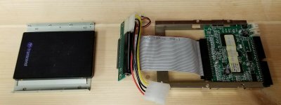

Yeah, looks like artmixs SCSI-CF cards are history. Sort of wish I'd bought a couple more. Last year I bought one of his SCSI-SD cards. I installed it in an external SCSI case and used it with a variety of Macs and Apple IIs with no issues.
This is the inherent risk of his approach, which was to use ACARD ASICs that are no longer manufactured. Once you deplete your supply, it's game over. As long as Cypress manufactures the PSoC 5LP that the V5.1 is based on, and people keep buying SCSI2SD's, we will continue to manufacture them. Demand has never been higher, and the field-upgradability is the strength of SCSI2SD (both V5 and V6), since corner cases and bugs can be resolved years later, as they're encountered. This is fundamentally impossible with the SusanoMonster boards.
