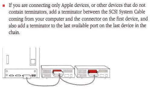

As a reference for people looking for how to setup a Mac Plus SCSI chain, here's a screenshot from the manual with helpful diagrams.
The long and the short of it is, the Mac Plus doesn't have internal termination, and in general behaves a little oddly compared to other SCSI-capable Macs because of its lack of internal termination. (It is possible to add a diode at position CR1 of the logic board in order to add internal termination to a Mac Plus, a 1N4001 according to the schematic, but naturally the manual doesn't address that, so the following assumes that the diode position at CR1 is unpopulated.)
Simply put:
  • If attaching a single SCSI device to a Mac Plus, attach a SCSI terminator (passthrough or not) to the second, unused port of the device.
  • If attaching two or more devices to a Mac Plus, attach a pass-through SCSI terminator to the 1st device in-between the device and the SCSI cable that connects to the Plus, and then terminate the unused port of the 2nd/last device in the chain as normal.
The general assumption with SCSI is that it is always necessary to terminate both ends of the chain, but with the Mac Plus, that first pass-through terminator is not necessary when only connecting a single device. (Honestly, I don't know why. Perhaps SCSI voodoo?) However, it is absolutely required if connecting 2 or more devices, as that first terminator block functions, essentially, as the "internal" termination for the Mac Plus's SCSI controller. (Any devices in between the 1st and last devices should of course be left un-terminated.)

I skimmed your link and even though the SE/30 is not mentioned (only the Mac SE) I assume (I hate to assume) the SE/30 and SE do the same thing SCSI termination wise.
For Macintosh Systems with only external SCSI devices connected (you can not install an internal SCSI device, or you have removed them all) you may need to provide external termination at the beginning and end of your external SCSI chain: This is true for the Macintosh Plus, SE, Quadra 700 and possibly other systems. I strongly suggest that if your system supports internal SCSI devices that you have at least one installed (and then follow the next part of this guide).
[mac logic board] <-> [terminator] + [2 or more external devices] + [terminator]
There is only one internal BlueSCSI desktop emulator in my SE/30 with its internal termination turned on. So I don't need a pass-through terminator at the beginning of the external SCSI bus, only a terminator at the end of the external SCSI bus. I usually don't have anything connected to the external 25-pin SCSI connector but that technically means that the SCSI bus is terminated only at one end but the bus cable is short, so it doesn't cause any specific issues with data reflections on the bus. I could plug a terminator at the back of my Mac SE/30 to be correct but it's not necessary.
Am I understanding this correctly?
You are understanding it correctly for the SE/30 with only an internal device attached. The internal device needs to be terminated, but you do not need to have a terminator on the external connection.
