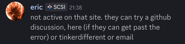

Hum this is very strange.
I will try to share your post on discord to let them know you have these problems.
Here is the answer:
