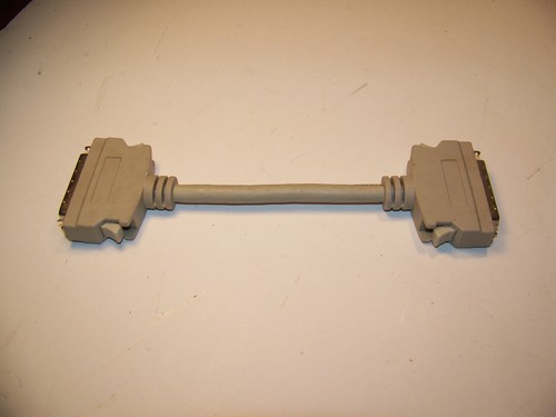

Well they are both 50pin, just with a slightly different internal connector one has two rows of 25 pins, and the other has a chunk of plastic between the two rows. I think I finally figured out what it is called but it doesn't help me so far at all as it seems rather obscure.
I believe it's a "Micro Centronics" connector:
However searching for that doesn't give any results really, and the only cables I can find with this connector are mislisted and just extensions not adapters.

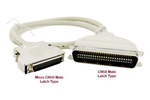

Alright finally found a cable that wasn't the same on both ends, I think I can adapter from there I'm going to try this:

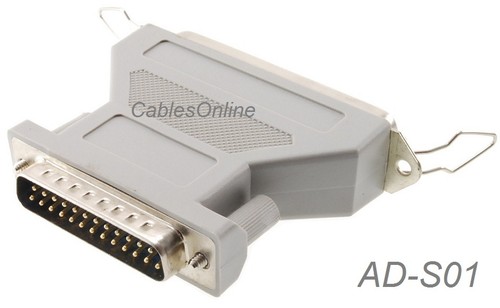

and then use this to get back to DB25:
Fingers crossed this works!
Technically, these are called Mini D(elta) Ribbon. So MDR-50 is the "correct" name.
