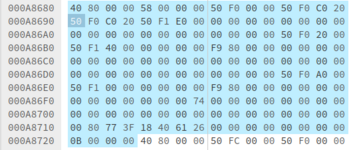

I found this article that gave me the first hook:
Based on that LC475 and Q605 can be determined from machine ID register at 0x5ffffffc.
So I started to search my LC475 ROM for 0x5ffffffc.
When started ROM is located at 0x40800000 in LC475.
I found 0x5ffffffc at:
0x40804874
0x4080489C
0x40804948
0x40804BE6
0x40881C0C
0x408A014C
0x408A0574
Based on Quadra605ROM.lst.txt those are located in
MEMORYCTRLINITPATCH
0x40804874
0x4080489C
0x40804948
GETHARDWAREINFOPATCH
0x40804BE6
INITMMU
0x40881C0C
SIZEMEMORYPATCH
0x408A014C
0x408A0574
I disassembled MEMORYCTRLINITPATCH and found code to initialize Wombat boards and "other"
Tables djConfigTable, djRefreshTable, BIOS_Config, and BIOS_Timeout mentioned in https://github.com/cy384/wombat-hacks/tree/main/rom-hacking were found in MEMORYCTRLINITPATCH with same or similar values and another one that is similar to djConfigTable but with different values in some enties.
(Do not forget: All I found is from LC475 ROM)
I was not able to read content of 0x5ffffffc with the debugger so I need to assume two things:
Assumption 1: I can not read 0x5ffffffc because of MMU configuration.
Assumption 2: The bit of Q605 Jumper and the two bits for clock speed are mapped into the lowest 4 bit of 0x5ffffffc.
Assumption 2 is supported by the fact that LC457 has 0xa55a0x2221 in machine ID register and Q605 has 0xa55a2226
which differs in bit 3 (if counted from 1) which is exactly where the Jumper is connected to U16 (74F244).
Clock speed selectors are at bit 1 and 2 (if counted from 1).
Next question to answer is: What is ROM doing in MEMORYINITPATCH based on the MachineID read from $5FFFFFFC?
First read at $5FFFFFFC does not take care about the least significant bits, but do something for some specific machines.
40804872: MEMORYCTRLINITPATCH+$000C: LEA $5FFFFFFC,A2
40804878: MEMORYCTRLINITPATCH+$0012: MOVE.L (A2),D3
4080487A: MEMORYCTRLINITPATCH+$0014: ANDI.L #$0000FF00,D3 ; mask everything except of 2 Byte for grouping Machines
Second one includes the least significant bits, but also only does some branches for specific machines.
4080489A: MEMORYCTRLINITPATCH+$0034: LEA $5FFFFFFC,A2
408048A0: MEMORYCTRLINITPATCH+$003A: MOVE.L (A2),D3
408048A2: MEMORYCTRLINITPATCH+$003C: ANDI.W #$07FF,D3
408048A6: MEMORYCTRLINITPATCH+$0040: CMPI.W #$0003,D3
408048AA: MEMORYCTRLINITPATCH+$0044: BEQ.S ^$408048BC ;MEMORYCTRLINITPATCH¹+$56
408048AC: MEMORYCTRLINITPATCH+$0046: CMPI.W #$0101,D3
408048B0: MEMORYCTRLINITPATCH+$004A: BEQ.S ^$408048BC ;MEMORYCTRLINITPATCH¹+$56
Third is the interesting one: First there is a branch for Wombat machines, doing something else. Then there is data read from tables based on the least significant bits of the MachineIDRegister, so if Assumption 2 is right, different data is read for each CPU clock speed.
40804946: MEMORYCTRLINITPATCH¹+$00E0: MOVE.L $5FFFFFFC,D0
4080494C: MEMORYCTRLINITPATCH¹+$00E6: CMPI.W #$2BAD,D0 ; Wombat devices contain $2BAD here
40804950: MEMORYCTRLINITPATCH¹+$00EA: BEQ.S ^$408049C4 ;MEMORYCTRLINITPATCH¹+$15E ; for Wombat devices jump
40804952: MEMORYCTRLINITPATCH¹+$00EC: LEA $50F0E000,A2
40804958: MEMORYCTRLINITPATCH¹+$00F2: MOVE.W D0,D3
4080495A: MEMORYCTRLINITPATCH¹+$00F4: SWAP D3
4080495C: MEMORYCTRLINITPATCH¹+$00F6: MOVE.W D0,D3
4080495E: MEMORYCTRLINITPATCH¹+$00F8: ANDI.W #$0003,D3 ; Mask everything except of CPU Clock Bits
At his line a 40Mhz LC475 can be forced to use the 33Mhz settings instead of 40Mhz by changing
ANDI.W #$0003,D3
into
ANDI.W #$0002,D3
Using this patch CPU does not take care about the least significant bit of MachineID address (which is assumed to contain least significant bit of clock selector) and will use either 20Mhz settings or 33Mhz settings depending on the second clock selector bit.
The LC475 ROM contains the tables listed below already known from the Wombat ROM. No bump configs found.
