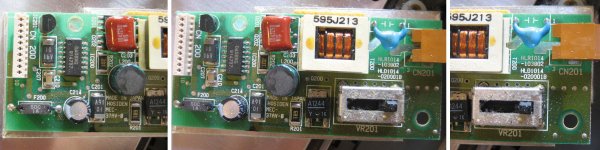

Attached are two pictures (top and bottom) of the PowerBook 170 inverter board. The brown two-pin connector connects to the CCFL, and the white 10-pin connector to the interconnect board and the rest of the computer. From what I can tell, most of the inverter board, as expected, seems to be dedicated to power inversion/transformation for the CCFL. It is a little difficult for me to tell what connects to what, but there seem to be ten solder points within the area of the potentiometer (presumably not all for the potentiometer), of which at least two connect directly to the 10-pin connector (at pins 3 and 8-) .

While waiting for some more insightful information from you guys, I made some basic measurements of the inverter board and input connector pinout myself. In case this information might be useful to someone else, I'm posting it here. Likely, the pin assignment is as follows:
01 Ground
02 Ground
03 Brightness potentiometer out (0–5.15 V)
04 Brightness control from the Power Manager (0.22–5.00 V – probably PWM, but not sure)
05 Unused
06 Power in (7.5 V)
07 Power in (7.5 V)
08 Brightness potentiometer in (5.15 V)
09 Contrast potentiometer in (FSTN displays)
10 Contrast potentiometer out (FSTN displays)
The question is if the input voltage is enough to drive a modern LED board, as modern inverter board input voltages seem to be higher. As suggested in the thread at MacRumors, I'll send a mail to lcdparts.net to see if they have anything to suggest.
If any of you have any other suggestions, or could confirm or elaborate on the connector measurements (in particular the brightness control signal), it would be very helpful.
