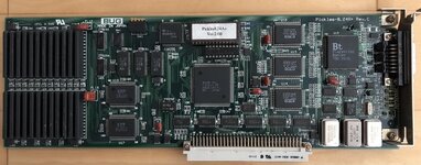

The Pickle is here! This is the B.U.G. Pickles 24A+ Revision C
First impressions: the nubus connector is cracked and the steel bracket is bent.
Nothing a bit of gentle plying won't fix! With a little care I bent the bracket back into shape and eased the broken part of the connector into a position that won't intrude on the pins. After a visual inspection for any damaged traces or bent pins I decided the card was ready to install in the Quadra 650.

That's about all I've done so far, having received the card from Fedex just a couple of hours ago. I'll add a couple more photos of the board below.
It's a bit dusty, yes... At some point today I'll take a look at the pictures of the earlier revisions of this card further up in this thread to see if I can spot any differences. Before that it is time to go and see just how high a resolution I can get out of this card.

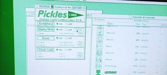

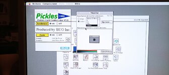

I finally had time to play with the cards in this #MARCHintosh, and here are some pics of my Mac IIfx with the Pickles 24A and the cdev; dip-switches on the card are all off except n.1 on:
Acceleration is on and the Zoom feature works flawlessly with ctrl + Up arrow:

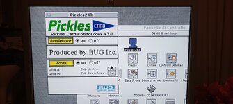

The setup is for million of colors:
and the resolution is 1024x768 with a virtual desktop up to 2048x1024 dragging the mouse down and/or right.

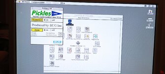

I also tried the other BUG card I have, the Pickles 24AW - this card started the quest that got us Shinbayashi san and his source code that @cheesestraws compiled... but the 24AW gives a 69Mhz output according to the screen, and it doesn't work well with it, so probably I should change the dip-switches.... but I can't find the correct setup. So far, the 24A stays in the IIfx, and maybe the 24AW will go in a Iici once I will figure out how to set it up.
I am so happy! Thanks everybody!

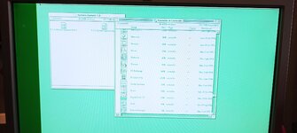

Now I am trying with the 24AW and this is what I get:
the screen says it gives 73.8 kHz as horizontal frequency and 69 Hz for vertical at 1600x1024... but I guess something is wrong in the autodetect/autoconfigure routine inside of it. Any hint? Change screen? :D

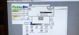

this card also gives the Display Mode Change control in the cdev (the 24A did not) :
but obviously nothing changes if I use it :(
@micheledipaola Do you have an adapter that lets you set it to sync-on-green? Either way, that's impressive. 1600x1024 ... what an interesting resolution. I love that these cards support all these oddball timings. I bet it's really useful on one of those widescreen CRTs from Sony.
I know it was over a year ago, but commenting here because I had the exact same problem with a Pickles 24AW (green screen, everything shifted sideways). The problem occurred with two different VGA adapters, a generic 6-DIP one and a Unimac 82D (with 16 switches). Solved it by getting a 10-switch adapter (a 'PTC' one from eBay), and found that it works perfectly with switches 1,4,5 turned on. Had to get my monitor to auto-adjust, but after that it was fine.
This is great news! I had no time to investigate this further, but now that there is a hint, I hope I will find time to do something. Thanks @Paulie and... could you please post a picture of your adapter?
