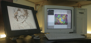

Back in 1999, I bought a second hand Power Mac 9500 from a graphics designer, in order to start learning graphics design myself. This computer came with 2 graphics cards and 2 displays; an Apple Multiple Scan 14" with integrated speakers and a beautiful Apple Multiple Scan 20".
I loved this setup so much, I tried my best to keep it since all those years. It has not always been easy. The 20" display is so heavy and the plastic becoming brittle, pieces have been broken several times while moving it. Room was missing and it has been difficult to find a safe and dry place to store it. The result is that the state of that monitor kept degrading until one point were I tried to convince myself to bring it to recycling.
This display has a strong sentimental value to me, it was a dream comes true when I got it, so I kept it anyway. Now with some inspiration from @jmacz 's amazing repairs, along with some great help from @TekTherapy , I decided to give it a try at fixing it. I also made some room on my desk for it to go back next to the 9500.
