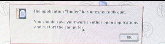

Hi. I flashed a Sun XVR-100 64MB with the latest Radeon 7000 Mac rom. (226, I also have 109 and 208 available). I'm getting some errors. On MacOS 8.6 with drivers installed, finder quits on boot (errors about crashing but never seems to actually crash). Adjusting resolutions crashes "Monitors and Sound", but still adjusts resolution. Can't open Diablo with Rave or OpenGL. (Crashes error 3). At various points, weirdness with display. (Shown below, moving window over screen with reveal) ATI displays sees it as a Radeon 7000 Mac.
Should I flash with older rom? Is this just to be expected?

About the Radeon 7000, here you can see that @Dandu used the official Apple flasher with its 208 ROM.
Maybe you should give it a try ...?
I had the some problem with a 7000 in a 9500 with a sonnet crescendo card, I gave up.
ATI drivers made the computer crash or having odd behavior.
To make things harder, french ATI extensions and english ATI have different names, you should mess with extensions to avoid mix-matchs.
I am using a sonnet card. I'll try the original or a NewerTech to see if it makes a difference. If not, I'll try redoing extensions from scratch.
I wasn’t able to try without the sonnet because I got the computer without the original card.
I’m curious to see how it works with the original card.
I think I found the issue. I had to disable Graphics Acceleration under the ATI displays menu bar panel.
Weird.
There's an incompatibility between the version of the ATI drivers that 9.2.2 loads and some version of QuickTime. I ran into it when trying to get classic OS loaded onto my MDD. There's an old thread about it around here somewhere.
Attempting again to get it working. I disabled the QuickTime extensions and it still has the same symptoms. Finder quits unexpectedly on boot. Launching Diablo II or Quake II results in type 3 error and won't load. Monitors control panel crashes when I change resolutions.
When I turn off Graphics Acceleration on the Menu Bar icon for ATI, the symptoms seems to stop. I can still choose OpenGL and RAVE in games, and it seems to even work, but I can't tell. Seems fairly playable. Finder still quits because on reboots, it restarts the graphics acceleration.
Any other ideas?
