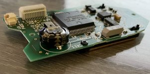

I’ve pulled my 150 apart, a lot of tiny screws & some desoldering. God knows how I’ll get it back together. I took photos but it may take a while.
My caps list doesn’t seem to match the one found here: https://mac68k.info/wiki/display/mac68k/Capacitor+List#CapacitorList-QuickTake150
My list is more like
3x 47uF 10V
1x 180uF 300V
2x 22uF 16V
1x 100uF 10V
and what Mouser has as a “supercapacitor V/MOUNT 5.5V 0.047F”.
It also has what looks like a PMU reset button. Is that perhaps worth trying before any recaps?
