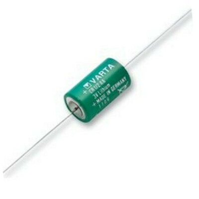

While we're discussing battery replacements, what do people recommend for replacing 4.5V batteries? Do these really need to be 4.5V or will something less work? You could substitute 3x 1.5V alkaline batteries but then you'd be creating a new battery bomb.

I use the same 3V Lithium batteries in my Macs that originally had 4.5V Alkaline batteries. Thread on this here:
I should have saved the dead 4.5V battery case and connector, but no biggie. So 3V actually works? That seems a little bit surprising, but is good news.
