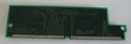

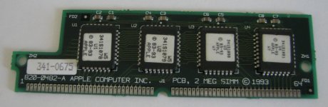

I've been playing with various ROM hacking stuff on the II series Macs, and I found this on eBay and couldn't resist snatching it up. It's a really weird shape!
Googling for the part number 820-0482-A seems to find a few results implying it's a 64-pin ROM SIMM belonging to a Quadra 840av. Further Googling is showing that some (few?) 840av models have the SIMM socket, but others (most?) have soldered ROM. I have an 840av, but haven't had a chance to check if mine has the ROM SIMM socket (and if there are clearance issues explaining why the SIMM is such an odd shape). Also, since the 660av and 840av share the same ROM, it might be for a 660av instead.
Can anybody confirm that this is for an 840av? I'm tempted to figure out a way to dump the contents to see for sure. I wonder if it is identical to the ROM version that is soldered on with later models?
I've been using a continuity tester and the JEDEC standard for 32-pin PLCC chips to figure out its pinout. The pinout is ALMOST identical to the II series ROM SIMM pinout, except the chip enable line on the four chips is directly connected to GROUND (always active) on this SIMM, and the SIMM pin that was used for chip enable on the II series is now another VCC pin.

For some closure on this question from long ago, I stuck the SIMM into my SIMM programmer board. I changed the firmware slightly on my programmer board to leave the CS pin as an input because it's wired differently on this SIMM than on the other II-series ROM SIMMs. Then I dumped the contents of the chips...
It's exactly the same ROM that is on my 840av's soldered motherboard ROM -- checksum $5BF10FD1. So I didn't discover any exciting lost ROM versions or anything like that. :-( Oh well! Mystery solved.

Just updating this post with the full pinout and physical measurements in case this helps anyone in the future who needs to make one of these or something...

Pinouts of each PLCC chip:

Size:
Dimensions are pretty much the same as my 8 MB ROM SIMM (see the EAGLE file at http://code.google.com/p/mac-rom-simm-programmer/), except there's a cutout in the upper left corner. The cutout begins 81.5 mm from the right side of the SIMM, and it begins 13.6 mm from the bottom of the SIMM.
Other notes:
It's exactly the same as the earlier SE/30 and II series ROM SIMM pinout, but with these exceptions:
  • The chips don't pay attention to the older pinout's !CE pin -- the chip enable pins on the four chips are wired to ground so chip enable is always active.
  • The older pinout's !CE pin is wired directly to +5V.
Chip markings are as follows:
U1 = 341S1078
U2 = 341S1079
U3 = 341S1080
U4 = 341S1081
Sticker on SIMM says 341-0675
PCB silkscreen says 820-0482-A
APPLE COMPUTER INC.
PCB, 2 MEG SIMM © 1993
One minor correction, I was reading the JEDEC standard for 512K x 8 single-supply EEPROM and I should have been reading the JEDEC standard for 512K x 8 EPROM. On the actual PLCC chips, pin 1 is VPP (so supplying 5V probably means don't go into programming mode) and pin 31 is indeed A18. So that removes the two concerns I had about the wiring of the PLCC chips themselves.
