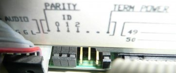

The speaker connector I can only put in one direction.
