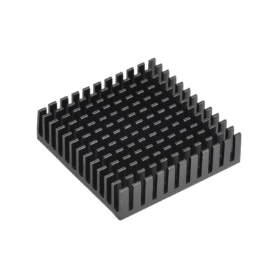

I recently added a Bolle Carrera040 to my IIci, using a 40mhz 68040 I bought from what I understand to be a reputable supplier on eBay. Everything worked fine but I was surprised at how hot the processor was to the touch. I ended up affixing a thermistor to the bottom of the processor, using very fine gauge enameled wire to pass through the processor pins, to see just how hot it was getting.
I was pretty surprised at how quickly the processor temperature ramped up. Admittedly I was trying to stress it out a bit by running some Speedometer tests on loop, but even after stopping the tests there wasn't much of a drop in temps. I then affixed a 50mm x 50mm x 20mm aluminum heatsink from Amazon using some thermal paste. I didn't have any thermal glue so I temporarily just affixed it with Kapton tape. The differences were dramatic - Temp rampup was much slower and hovered around 50C or slightly lower. I hammered it with way more loops of Speedometer tests (I pulled the plug on the tests without the heatsink when I saw temps get up to 105c or so) and the temps held firm. I played around with blowing a fan directly over the heatsink and that got temps down to sub 40C.

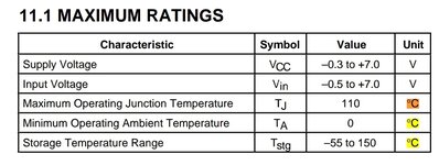

I have to admit I'm slightly shocked - an 040 shouldn't run at anything near 100°C - it should crash way before that? I'll check a datasheet ...
Yup, max junction temperature 110°C, I'm astounded it was still running with a measured 105 on the exterior of the package, even if it was the metal underside. How accurate is your thermistor and are you using the basic linear calculation to get the temperature, or the more fancy nonlinear formula?
