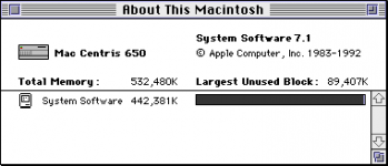

Rob told me a little about the Q650 memory expansion in PM. The image shown there is probably with a large RAM disk. Above some value, he must allocate the extra memory to a RAM disk or it causes system problems. Still, he's got the available memory way beyond the original spec. or had when he PM'd me.
Yeah, it's a work in progress, but a half gig in a 68k mac ain't bad. A larger RAM disk than stock HDD, and more available memory than the stock ROM allows isn't terrible.
