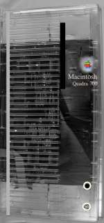

A Quadra 650 MoBo should be exactly the same form factor as the 7100's. There's a 7100 MoBo in Shelob's gullet, everything lines up perfectly, reset switches, LED light tube, speaker carrier/MoBo retainer and two of the Slots. She ate the @$$ end off the 7100 too, so she's got all the NuBus Slots clear as well as the PDS VidCard's backplane.One of these days, I'm going to see if I can get the Q650 logic board in the Q700 case. I adore the IIcx/IIci/Q700 case design, but the Q650 has several advantages over the Q700.

Yes, I believe that the case for the IIvi/IIvx, the C/Q650 and the PM7100 were all the same or essentially the same. But while that case has the spot for the optical drive, there's still something about the IIcx/IIci/Q700 case that I like better.A Quadra 650 MoBo should be exactly the same form factor as the 7100's.One of these days, I'm going to see if I can get the Q650 logic board in the Q700 case. I adore the IIcx/IIci/Q700 case design, but the Q650 has several advantages over the Q700.
Twice the memory capacity. And I have all the 72 pin 32MB SIMMs on hand that I could ever use and very few 30 pin 16MB SIMMs. Hence the perpetual $3 32MB SIMM sale.Tell me what's better about the 650 MoBo besides the speed bump and the extra NuBus Slot? :?:
