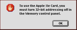

I found this out the hard way when I bought a Quadra 630 thinking that it would be compatible with the IIe card. I was never able to figure out a workaround...

Tell it to me brother! That was exactly what I did. I put all this effort into trying to force 24-bit mode because I wanted to run the Apple IIe card. I even hacked the Apple IIe Startup software to skip the memory mode check -- it just crashes.

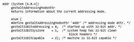

Indeed. Sadly, the perfect Gestalt did exist for this:
addr (System [6.0.4])
gestaltAddressingModeAttr
Returns information about the current addressing mode.
enum {
#define gestaltAddressingModeAttr 'addr' /* addressing mode attr. */
gestalt32BitAddressing = 0, /* started up with 32-bit addr. */
gestalt32BitSysZone = 1, /* system heap has 32-bit clean
block headers */
gestalt32BitCapable = 2}; /* machine is 32-bit capable */
They simply should have added gestalt24bitCapable=3. They could have done so in the ROM or System Enabler.

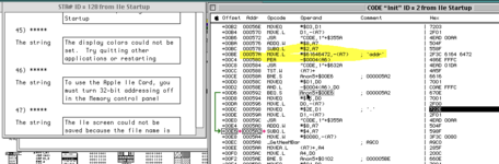

My usual process is to run an application and generate the offending alert. Then, break into Macsbug and scroll backwards in the code or the stack to see what code generated the alert box.
After I identify the likely code location, I open the application in ResEdit for deeper investigation and alteration. In this case, we see a 'gotcha' line of code at address 0057A (highlighted in yellow below). The constant value 'addr' is being pushed on the stack. That constant is used to determine addressing mode in Gestalt.
The code then jumps to a routine at CODE,1+$632A which contains a safe wrapper of the Gestalt function. Upon return, if there is an error code (non-zero), the application continues assuming it must be a 24-bit system. The gestalt selector 'addr' was introduced in System 6.0.4, which is the earliest system supporting the 32-bit clean ROM (Mac IIci) computer.
Assuming no error is returned by the Gestalt wrapper call, the code checks the least-significant bit of the 'addr' return value, which indicates whether the machine is in 32-bit mode. If the result is zero (BEQ), then the machine must be in 24-bit mode and the application jumps to address 0005A2 (green arrow above) and runs as normal.
If instead the machine is in 32-bit mode, then the application loads the constant #$2E (which is 46 decimal) and calls another subroutine. No surprise, STR# 128 index 46 is the error message to indicate 32-bit addressing must be turned off. That confirms we definitely have the right section of code.
By altering one of the previous branches or compares, we can cause the application to always believe the machine is in 24-bit mode and run anyway. Sadly, this is where I determined that the IIe software would eventually crash, suggesting the code is indeed not 32-bit clean.
There is a nefarious scenario where the programmers intentionally crash the application in later code. If we had just bypassed some copy protection, I would assume that I had not completely removed all of the checks. In this case, I believe Apple just didn't want to invest in updating the code (and maybe hardware?) to be 32-bit clean.
