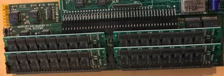

And even though this...
...might look funny it is not actually useful![]()
The IIsi Pivot and MacCon will still fit nicely on top of that, so no problem if you do not need to run big cards like the XCeed....
