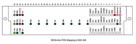

Interesting! We've three(?) reserved lines on the 030 PDS available to the new build logic boards. You might consider options for implementing those in the proposed multifunction adapter riser with NuBus?
We'd talked about schematic development of NuBus in Macintosh II v.1.0 and a member just happens to be in the process of troubleshooting that very board. Detailed pics there. Direct link to overview pic: Thought here is to strip away the NuChip implementation from the existing Mac II schematic, place components in a visual diagram and buzz connections in order to begin to get a picture of what's going on there?
Found something new and very interesting on the DuoDock NuBus front as well. Still trying to determine version dates and align them with the two relevant Block Diagrams in order to wrap my head around it. Might be promising? Dunno, but it's definitely yet another window into Apple's implementation of the elusive NuBus critter. :)
Here are the three "Reserved" pins on the 030 PDS and everything else but Address/Data buses. ISTR a reserved pin in one machine/adapter or another having been connected to something, but damfino what it was at this point. Pin 2C lost its /NUBUS or n.c. label below.
If the reserved lines don't go anywhere on IIsi or SE/30 logic boards that'd be ideal. If they do go somewhere, maybe they can be cut without borking anything? In either case they might be patched to wherever they need to go on either machine's logic board to run necessary lines up the riser to implement more than a single slot?
Column labels went missing too! Top's A, bottom's C.

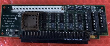

Has anyone seen one of those? Do they have chips on the back or just the front? Looking at it again (prompted by this thread), it only has six 8-bits transceiver chips instead of the expected eight. There's also more ALS240 than in Apple's implementation, so maybe a slightly different bus driving scheme. If those GAL/PAL can be read for configuration, all the chips are still being made, that one would probably the easiest of all implementations to replicate.
GALs from the Radius adapter have already been read long ago:
Downside with the Radius adapter is that it will run synchronously at half of the host clock… in a IIsi that works out perfectly to run a 10MHz Nubus clock, in the SE/30 that design will run Nubus at 8MHz.
The state machine they implemented doesn’t account for asynchronous operation.
Neat. Did anyone trace the board as well?
Downside with the Radius adapter is that it will run synchronously at half of the host clock… in a IIsi that works out perfectly to run a 10MHz Nubus clock, in the SE/30 that design will run Nubus at 8MHz.The state machine they implemented doesn’t account for asynchronous operation.
If it is running half-clock just to avoid the cost of an extra clock, then it's an easy fix. If it's somehow requiring the clock to have some relationships in the GAL/PAL, then it will be harder to 'fix'. But in either case, with the appropriate schematics, it should be possible to recreate the board with either modern PAL/GAL or replacing them all by a single CPLD, and then figure out how to 'improve' it.
As for synchronous, that's for slave mode I assume, as for bus mastering they have little choice, I believe the IIsi memory controller is fully synchronous and will only answer with /STERM.
Pretty sure it’s about more than just adding a clock oscillator.
The implementation is so simple because it doesn’t have to glue together two different clock domains of the Nubus and processor bus.
Apples discrete Nubus implementation needed 12 PALs instead to do this, so I don’t think it’s easily added to the simpler Radius one.

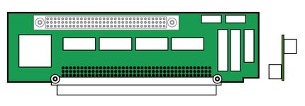

Knocked together this rough of the plan last night and this morning.:
"Periscope" PDS daughtercard is on the right. Original plan was to harvest Apple's NuBus Controller and stick the FPU socket in the space of the Radius controller on the right side above. Has anyone done a schematic of the Apple adapter?
New parts available Radius adapter is the new goal. Cannibalization of the Apple controller is then avoided for all but my one off prototyping effort.
@Bolle does the periscope PDS adapter board provide enough real estate to work your magic in four layers?
Figured out why that first rough in of the plan didn't look right this morning. The Passthru connector was overlaping the motherboard connector pins OOPSIE! No wonder there looked to be far too much room between interconnect and NuBus slot.:oops:
I'm figuring that just about any expansion card in the PDS Slot will have a socket for the FPU. So that's been eliminated in hopes of doing this version of the Radius NuBus adapter in just four layers?
Thinking a straight thru path from PDS->Buffers->Transceivers->NuBus Slot will be optimal in its simplicity? Gray chips are the buffer/line drivers on the solder side of the PCB. There are a few more bits to add to the layout, but thinking I've got the major components configured into what might be possible in four layers?
Dunno, whatcha think gang?
