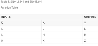

How will you troubleshoot to figure out where the problem lies, taking advantage of the fact that you have one working board? We have the tools we need to figure it out, we just need to proceed scientifically and gradually so that we only solve one problem at a time.
You have a lot of faith in your IC tester. I like IC testers too --- I'm a big fan of my own Retro Chip Tester Pro: it's a fantastic tool. Remember though what I said earlier: you can usually trust an IC tester if it says a chip is bad, but it's less trustworthy if it says a chip is good. Here are some reasons why this is so:
  • Chip testers may only drive the inputs to an IC at a certain frequency. Recall that U8B and U9B are 74F-series chips, where "F" stands for "fast". The 68000 will be sending new signals to these ICs at maybe around a megahertz, and the chips will have to respond very quickly in order for the Lisa MMU to work properly. It's unlikely that your chip tester is checking for a correct response at that frequency --- and if its test for 74283 4-bit adders has to work across all 74-series families (not just F) then it must run more slowly than the speeds the IC is capable of.
  • Chip testers will only ever need to drive and listen to one chip at a time. In real circuits, ICs live in a network of many other ICs, with complicated networks of "speakers" and "listeners". Chip testers therefore test an IC in close-to-ideal conditions, not real-world situations. An IC that works well in the simulated environment of the tester may still not be strong enough for an actual application.
  • Most chip testers don't have anything to say about the quality of an IC's outputs. (There are a few that do.) Remember that +2V is still a valid "high" level for TTL, but if I encountered an IC that could only drive a chip tester's input up to (e.g.) +2.6V, I'd consider that part to be extremely marginal and would look for a replacement immediately. But most chip testers don't say what the voltages coming out of the chip are like.
All this is why a chip tester's verdict of "good" isn't always so informative: it means "good under ideal conditions". Meanwhile, if a chip is bad even in the IC tester's kindergarten, there is very little hope for it anymore --- throw it away!
I hope all this information is useful. It's a lot, but if you take a moment to read it all, some of my suggestions from earlier may make more sense.
By now it will be no surprise that I think we should continue trying to understand why UA9-UA16 signals are not TTL. The four possibilities I listed above are all still potential factors. I have my own theories about which possibilities are most likely than others, but I'm not yet confident about them. Instead of sharing my hypotheses here, I'll be interested to hear what you think first.
What do you think might be going on with UA9-UA16? How would you test to see whether your hypothesis is correct? If you like, let me know and we can work from there.

Now as much as I like to focus on one problem at a time, here's a remark about U8C:
I haven't been considering the data lines too much because I don't think they should have much to do with the address lines. It's possible that if U8C is broken, then both the CPU and some other IC on the data bus might both try to drive the data bus at the same time. This is never an ideal situation: if device A wants to raise a signal line to +5V and device B simultaneously wants to lower the line to 0V, then device A will pump a lot of current into device B over that signal line. Perhaps the 68000 is getting into one of these bad situations, and this is causing it to drop the voltage it's sending out onto other pins, like UA9-UA16. (I don't think this is too likely --- why only those address pins and not others? But I don't know enough to rule it out.)
Anyway, if there is a problem with U8C, it may be possible to spot it without removing the IC from the CPU board. As long as pin 19 is low, then whatever signal goes into pin 11 should cause the opposite signal to come out of pin 9. (If pin 19 is high, then pin 9 will no longer track pin 11 --- U8C can no longer control that signal line.) If you don't observe this behaviour, then U8C is behaving suspiciously.

  • pin 19 of U8C - is static LOW - always. No activity
  • pin 11 of U8C - has an activity between 0 and +5V. So \READ pin of CPU 68000 has the same activity
Thanks for answering all of the questions. You are getting a lot of practice desoldering DIP devices from mid-'80s 4-layer circuit boards!
Regarding pin U8C: very interesting, but very confusing! If pin 19 is LOW, then U8C should be passing (well, after inversion) READ through it: if you don't believe me, you can check the datasheet :)
Since this is not what we observe --- A is changing, Y is not --- then we are confronted with another mystery. Either your IC tester is mistaken and U8C is faulty, or there is something wrong with other devices on to \READ: they're somehow able to supply strong enough current to \READ at +5V that despite U8C's best efforts, it can't pull \READ down to 0V when it needs to. (Or there's a problem with the wiring itself, like there wasn't last time.) I'm not certain what would be a likely candidate for a bad IC yet --- there are several ICs on the CPU board that listen to \READ.
Meanwhile: as for pin 19 always remaining low, it looks like the BGACK signal going into pin 19 may not behaving as we might expect. Let's trace it backwards. There are several ICs that listen to BGACK, but in your setup there should only be one device driving it, which is U6A --- a NOR gate that's being used as an inverter. And that NOR gate should only be driven by the CPU at the moment since there are no other cards in the machine.
Measure CPU pin 12. If you see activity there, or if it's also low, then U6A pin 13 is not emitting the value that it should, and this should be investigated further.

I think U8C is good, because I see the same (pulsing) signal on pin 9 (it is output Y) as on pin 11 (input A from the function table). I also don't believe that IC tester could be wrong for such easy chip.
When I got removed chips on bad board from sockets (ROMs, U8B, U9B) pin 11 on U8C was static HIGH and pin 9 was also HIGH - I wrote about it earlier. On the good board those pins ale pulsing with removed chips from sockets (ROMs, U8B, U9B).

PIN 19 in U8C is LOW in both cases. So in my opinion we should look evidence here, why \READ pin which goes to pin 11 U8C is not pulsing (as it does on a good board) when ROMs U8B and U9B chips are removed .
Is a something else that has impact on CPU code that its pin 9 (and pin 11 on U8C) is always HIGH on bad board? Or is it somenting after U8C? hmm
