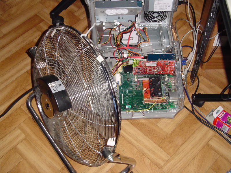

The thermal pad I'd remove the film and repaste, and pointing a large desk fan at the internals while running will help you to determine if overheating or a marginal/faulty CPU.

to check if it is indeed a thermal problem I would run it full speed with the case opened, then do some stress tests.
If theres no problem, it is heat related.
