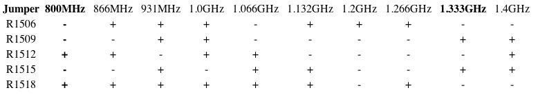

The 2003 eMacs have an entirely different internal design as opposed to the 2002 eMacs. However, the motherboard design was largely unchanged aside from the omission of L3 cache provisions and replacing the 483-pad CPU with a 360-pad CPU, more akin to earlier PowerMac G4s.
On the 2003 eMac, this is what you need to look for:
And here are the resistors close-up:
And here's the chart:
A plus indicates the presence of a jumper, and a minus indicates the absence of a jumper.
I've personally had success with overclocking these to 1.33GHz and 1.266GHz. On the earlier 800MHz G4 eMacs, your mileage may vary.
vcore (OPTIONAL):
This can be a bit hard to read, so here's the map:
R4718 = Vid0
R4719 = Vid1
R4720 = Vid2
R4721 = Vid3
R4722 = Vid4
And here is the jumper table:
Obviously you'd only do this if you're crazy enough to bring it to say, 1.5GHz... but I'd personally go for 1.33. You could also use this if you ever decide to swap your ATI eMac's CPU with a 7447 and need to undervolt. However, there's a more practical way, and that's called buying a USB 2.0 motherboard. Either way, the ATI eMacs still make stellar Mac OS 9 systems.

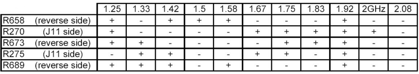

These are by far the best eMacs of the bunch. However, not all of these are created equal! There have been a few different versions of the PowerMac6,4 boards:
-Original USB2 board, 820-1591-A with purple CPU - Original PowerPC 7447, can only be brought up to 1.42GHz stable
-Original USB2 board, 820-1591-A with green CPU - PowerPC 7447A, can be brought up to 1.5GHz stable (Yes, one person has brought theirs to 2.08GHz, but I call BS even with their GeekBench score.)
-Education 2005 USB2-based board, 820-1798-A - PowerPC 7447B, can be brought to 1.75GHz stable at 1.350V
-2005 "Q86J" board, 820-1739-A - PowerPC 7447B, can be brought to 1.92GHz stable at 1.375V; by far the best possible eMac configuration without doing... too much. My name is not dosdude1, unfortunately.
The first 2 do not need vcore adjustments, but the last 2 do if you're going above 1.67GHz. The PLL resistors are on 2 sides of the board this time:
This is where the hard drive usually sits, and here you will find R658, R673, and R689:
On the CD-ROM side you will find these 2 resistors, R270 and R275:
And here's your resistor shot:
Here's the table (which I added the 2.08 setting from the Macbidouille forums):
-Purple CPU USB2 eMacs can go to 1.42
-Green CPU USB2 eMacs can go to 1.5
-eMacs with the 820-1798-A board can go to 1.67 without vcore increase, or 1.75 when adjusted to 1.350V
-Q86J (2005) eMacs can go to 1.67 without vcore increase, or 1.92 when adjusted to 1.375V.
Vcore (Optional on certain clocks!!):
The USB 2.0 eMac uses the same voltage regulator for the CPU as the ATI Graphics eMac. Refer to the vcore chart from the 2003 section. However, the resistors are labeled differently:
R453 = Vid0
R454 = Vid1
R455 = Vid2
R456 = Vid3
R457 = Vid4
I have managed to get my 2005 eMac to 1.92GHz back in 2020, and it still runs like a charm. Some nights I've been using it as a white noise machine and it's been on for a while by now. Why is this possible? The cooling system was not cheaped out when the USB2 eMacs came out, and the 74x7 chips were known for running much cooler compared to the 74x5 and 74x0/74x1 chips due to the smaller manufacturing node.

>That particular setting is broken. Not sure why, but it appears to be an OF-related bug. USB2 eMacs I would personally go for 1.42 or 1.5, depending on the model.
"Why is my geekbench score lower and why is my system running slow?"
>You might have messed up your PLL configuration by setting it to the wrong speed or your system is potentially thermal throttling. You might have also set your voltage too high or too low. This is also an indicator that your overclock may not be 100% stable.
If you've made it this far to overclock and have it stable, I applaud you! You have something that was easy to find yet competitive with the best single G4 upgrade cards in terms of CPU power, perhaps better with the 167MHz bus. The first 3 eMacs make great OS 9 systems (the USB 2.0 needs some patch work) and having a faster OS 9 system is always kind of a nice novelty. The CRTs on these eMacs are great as long as they're not too worn out, and they also make great OS X machines. The 2005 eMac is my personal favorite as that nearly reached 2GHz, and runs like a champ. It's a good Leopard mac too, considering it has Core Image support. Yes, the graphics cards on the eMacs are not particularly nice, but the CPUs can manage to outperform a 20" iMac G4 with a little work done!
