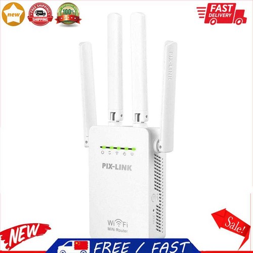

Can't help with your question directly, but my default solution for all my vintage machines is one of the very cheap wifi bridges linked below connected via ethernet to the computer in question.
Connect it via ethernet, log in to it's admin interface, put it in Repeater mode and connect it to your wireless network. After it restarts it is basically a dumb wireless ethernet port with all DHCP assignment / routing handled by whatever is upstream of your wifi network. You can even connect a switch to it and connect as many machines as you want. You can't turn off the wifi repeater, but you can hide the SSID so it doesn't clutter up your wifi list.
It started as a project to wirelessly network cnc machines across a large open workshop (commercial solutions for this are ridiculously expensive) and it worked fine, but I soon found a better purpose for them ;)
I have used this setup on everything from my Quadra 700 to my W10 gaming PC, and it always works perfectly with no hassle. It even worked with my G4 Cube, when the Cube for some reason locked up when connected directly by ethernet to my router.

The solution lobust mentioned is likely the best overall option, especially as volvo242gt said in some wireless networking configs using devices too far out of date may slow down performance for newer devices. Lots of modern mesh systems let you hang ethernet-based devices off of ethernet ports on each node, and some modern routers simply have a client mode where they join the network as a client and bridge or NAT to clients on their own ethernet ports.
