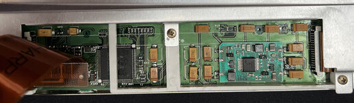

@jmacz do you have a photo of the completed LCD driver board with the tantalums? Just curious how it looks.
Here's a picture.
Note that a couple of the caps have a dark mark on them.. that's because I used a black felt tip marker to mark them as I was testing them trying to figure out what was going on earlier. I was able to remove the marking on the other caps but two or three of them wouldn't come off. Not like I care but just wanted to explain the mark in case anyone was wondering why there's a dark spot on the cap :)
LOL... of course. I put one tantalum cap back on at a time and then plug everything back in to test the display. And test the continuity on each end of the cap with where it should be connected to. One by one. And of course, the display works after each cap is replaced and continues working even after the last one... 😭 So they all work and it's all good now.
If it helps, this is basically the kind of thing that happens to everyone. Nice result, though - very neat.
