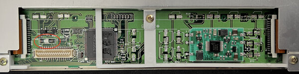

This circled component is the only thing that remotely looks like a fuse on the board, and it has continuity (it's not open) so I think it's fine?

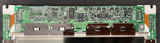

And here's the other side of this board:

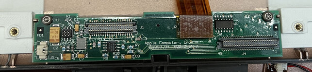

Nothing there that looks like a fuse (ie. I believe surface mounted micro fuses would look like a surface mounted capacitor but the center ceramic portion is white and/or the component is label F<something>). Nothing like that from what I can see on the bottom. Nothing like that on the bezel board either:
