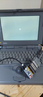

I have a working / booting PowerBook 145b from the internal hard-drive.
I have a DB25 bluescsi device.
I have a HDI-30 to DB25 cable.
If I don't plug the cable, the PowerBook boots from the internal hard-drive.
If I plug the cable HDI-30 to DB25 to bluescsi (which is also powered by USB), the PowerBook shows the Mac with a question mark. It boots to the internal hard-drive if I remove the HDI-30 cable.
If I plug the cable HDI-30 with bluescsi after booting from the hard-drive, the laptop eventually freezes.
Has anyone managed to use bluescsi with a Powerbook via the external SCSI connector? Can such person describe precisely his setup?
