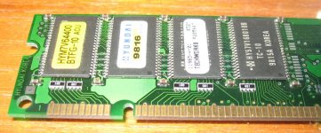

Didn't know which type, so I pulled a pair of known good DIMMs from the BG3-DT and tried them:
NOT the correct type I'd imagine as a new error code "KILL ME! KILL ME!" occurred after only about one second or so.
Switched back to the original DIMM and got the same "KILL ME!" error code after approx ten seconds. So this one appears to pass memory test, which shouldn't take anywhere near that long to complete?
I thought I'd read that Apple moved to the same memory type as the parallel BeigeG3 project's new architecture as well. But that doesn't make much sense to me now that I think about it. If PEx/PowerExpress/9700 was an update of the 9600's architecture, it stands to reason that it would employ the x600 series memory setup, no?

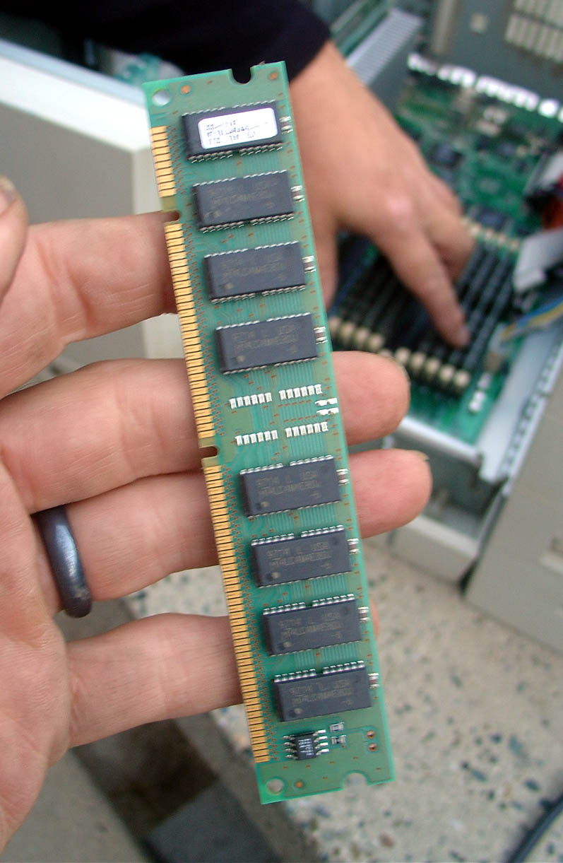

Ah, found this at Digibarn:
From the notches, correct me if I'm wrong, that appears to be unbuffered, 3.3V memory. And I saw EDO on one of the labels. Ah, but that was on jt's DIMM. Which takes about 10 seconds to fail. Still, suggests the PEx wants EDO.
I don't know what that little chip on the end is doing. I hope it's just helping with addressing, but it could be an SPD chip, in which case memory for these things is a lot harder.

The only unknown is that the notches don't tell you if you have 3.3V unbuffered EDO memory or 3.3V Synchronous DRAM.
jt's experiement with his Beige RAM would suggest that it wants EDO and not SDRAM.

X500/X600 RAM has the notch at the end in the center position. Which means Registered or Buffered. The notch in the center of the DIMM is in the Left position, which means 5V.
SDRAM such as the Beige uses has the notch at the end in the Left position, which means unbuffered. The notch in the center of the DIMM is in the Middle position, which means 3.3V.
The PEx DIMMs appear to have their notches in the Left and Middle positions respectively, which means Unbuffered 3.3V.
No way of knowing if that means EDO or SDRAM. But I'm going to take a closed look at the Digibarn picture. If I can make out the part number on the chips, I'll be able to look up whether the chips are EDO or SDRAM.
I can't make out the part number on the DigiBarn DIMM beyond MT4LC. Searching some parts that start with that gives FPM and EDO.
Looking at the photo of Captain Serial's DIMM, the chips used are EDO.
So I think it's pretty certain that it needs 3.3V EDO memory.

I can make out the little chip on the end of the DIMM and it is a 24C02 from, can't quite tell but I think ST Micro. Which makes it a little serial Flash.
Which suggests these are 3.3V EDO DIMMs with an SPD chip. That may complicate matters.

Flip side of that DIMM in the working PEx documented in the thread @captainserial posted. Shouldn't this be all you need to ID memory spec?
We've got three Batch A/EVTA boards in the MLA, I wonder how many Batch E/EVTE boards are out there. DigiBarn's may well be the only one. It has the connector and components for that VidSlot thingie implemented. I'll hazard a guess that there's no way we're going to boot an EVTA from these EVTE ROM DIMMs. EVTA will never get past the hardware check, no?
HA. So it is 3.3V EDO. Interesting. GLT4160L04-60TC
