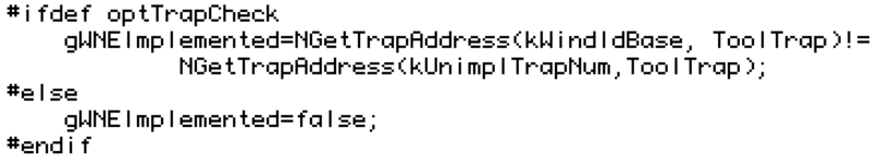

It has a MacTraps interface for ToolBox APIs that use the pascal calling convention, unless it somehow interprets the trap numbers themselves. My next attempt was to use ThinkC under System 7 to write an app in 'C' which can do the same job. It still crashes when I run it on System 3, I think I need to add InitPacks().
Actually, I solved the problem for why the ThinkC version was crashing under System 3 or System 2. It was because my gWNEImplemented routine which uses NGetTrapAddress() doesn't work under those Systems. I should go back and refer to the technique used in https://68kmla.org/bb/index.php?thr...-os-system-1-using-codewarrior-gold-11.47511/
I just do:
I've now undefined optTrapCheck.
