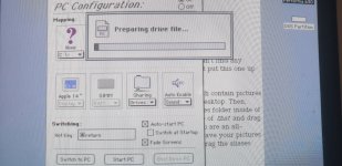

@Ries, what OS version are you running and what version of the PC Setup control panel do you have installed?  I have 1.0.6.
I feel like this is almost certainly a Mac OS 8 issue but maybe can be resolved with an extension version between 5.1.2 and 5.3.1 but I doubt I have it.  Anyone?
