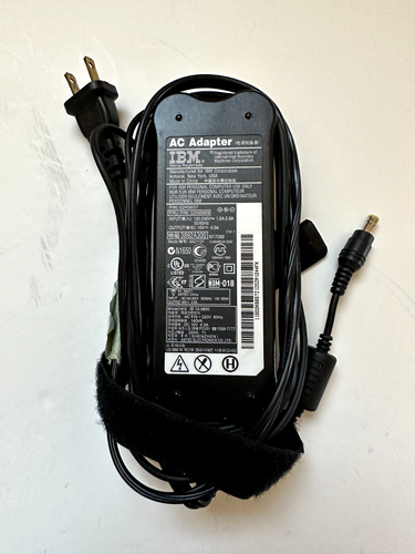

I ended up replacing my PB520 PSU with one from a IBM laptop, and spliced the old 520 cable onto it... I kept the original PSU, but there's to much magic smoke inside for me to bother with... It's far smarter for me, to use a modern power supply..
New one is IBM 16v 4.5A

The adapter for my 520c was becoming unreliable and would sometimes fail to power up the laptop. I cut the cord off and soldered it to a barrel jack salvaged from a dead pc laptop and sealed it with heat shrink tubing. This way I can use any standard unmodified PC laptop power brick supplying 16v and also one less power brick I have to keep around.
I wired both vbatt and vmain to the positive pin on the barrel jack. On my cord both gnd and gnd sense were connected to pin 3 and pin 4 was unused, both are connected to negative on the barrel jack. Not sure why apple wired the battery and main supplies separately since they are both the same voltage. I don't have a battery to test if it still charges this way but the 520c itself is working normally
