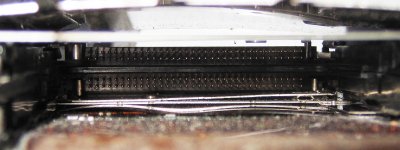

But there is also a problem with the PCMCIA cage: the upper slot worked only once, the lower slot does not work - both slots seem to not fit very good and I suppose cards were put in with force in the past.
I have two spare 5300cs logic boards, so my question is:
is it difficult to replace the PCMCIA cage?
