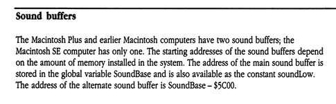

It is :) there are actually two, that are switchable. But take care, floppy drive speed info is stored in the primary buffer, so you need to make sure you switch back to it.
The buffer is in main memory.
Oh neat, but how would I tell Sound Manager to stop writing to it, so that I have full control? Also, do you know the linear addresses for these buffers?
Just checked, the SE dropped the second buffer, it was only available up to the Plus.
The address changes depending on how much RAM is installed, but it is stored as a global variable. See chapter 13 in that book I linked.
Note it is every second byte - the low byte of each word is the flopy drive speed because... thats how things are when you use the CPU to control the floppy drive and implement variable speed floppy drives to increase capacity.

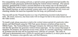

Oh and another thing I've been wondering about. Timing on 68k Macs seems to be done either through Time Manager or the vblank callback vector, but the vblank rate is not guaranteed to be 60Hz, is it? Some Mac monitors ran at 66-67Hz, for example. How would I detect the nominal vblank rate?
Compact macs have a fixed rate, it isn't exactly 60hz though. The timings are in the book. Check the audio and the video sections.

So I'm going to target 68020+ and use one Sound Manager voice, and I'll use a vblank interrupt/callback for player timing, I think. However, like I asked earlier, how do I detect the vblank rate? Some Macs have 66-67Hz video modes (12" Apple RGB monitor etc.), and that would mess with my timings if I expect a nominal 60.15Hz
Sorry, you want to use VBL for timing of sound playing, or for flicker-free animation?
You generally should not need to know the VBL refresh rate. If you use the Vertical Retrace manager to install a VBL task with _VInstall, it will always run 60 times/second on Macs with the Slot Manager, so the actual video refresh rate doesn’t matter.
If you really need to sync with the actual refresh rate of a particular non-built-in CRT e.g. for flicker-free animation, you need to use the Slot Manager routine _SlotVInstall to do that. See the Slot Manager chapter of Inside Macintosh Volume V.
If you want a callback rate other than 60 Hz and don’t care about syncing with any specific monitor, you should instead use the Time Manager and just specify whatever frequency you want.

I don't really need to sync with vblank for timing, but it just sounded convenient and simple. I guess I can just setup a 50Hz (or any arbitrary value) timer with Time Manager instead. Good to know that vblank callback is 60Hz regardless of the actual vblank rate, though. Pretty strange, but I guess it does some waiting or something to make sure it's 60Hz even on 66-67Hz rates.
Also @Phipli: I'm a guy, so now you don't need to use "they" again. :)
It doesn’t do any waiting, it’s just completely independent of vertical blacking. On Macs with the Slot Manager, the retrace interval of whatever monitor you happen to be running doesn’t impact when system-required tasks like the Stack Sniffer or updating TickCount happen (and indeed, you don’t particular want it to), so those things just happen 60 times/second no matter what.
