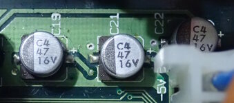

5. Hey! What about the LC III with the backwards capacitor that everybody argues about?
I've held onto an LC III without recapping the motherboard or power supply for just this occasion. When it starts up, the speaker makes a horrible squealing noise. In fact, it just keeps making awful sci-fi noises as long as it is powered on. There is no way this can transfer a file at the maximum baud rate without errors.
Oh drat. It works just fine. My whole world of recapping is a lie.
