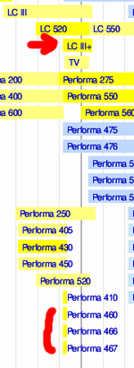

The LC III+ rolled out at the end of the LC III's life and didn't even get a proper badge (*hint* *hint*). It was just labeled "LC III". The Performa 460/466/467 launched for holiday sales in late 1993 and no more were produced. This possibly gives the Performa 460 the title of "shorted-lived Macintosh".

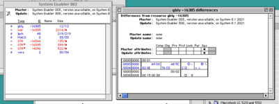

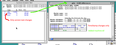

Let's start with just the revision of System Enabler 003 (for the LC III/LC III+). It was updated in April 1994, going from v1.0 to v1.1. Apple says "Updated in System Update 3.0. Minor bug fix for compatibility." But, when comparing v1.0 to v1.1 there is only one changed resource (besides the version number text).
In the gbly, Apple updated the timestamp to show this System Enabler is newer and added machine $0038. Convert that to decimal and add 6 to get the gestalt ID. That's 62, which is the LC III+ / Performa 460.
(To learn more about 'gbly' resources, see an older post:)
That's the only change Apple made. No code changes. In other words, they simply told the operating system that System Enabler 003 works for both the LC III and the LC III+.
Why? Because Apple hadn't updated the badge on the LC III case. Users were told they needed System Enabler 003 for their "LC III", but were unable to boot because they actually had an LC III+. Add the LC III+ machine id to System Enabler 003 and the problem is solved.

Let's compare Enabler 003 and Enabler 308. Hmm. A lot more changes?
The only difference in the 'gbly' is the timestamp. Same machines are supported. 'MACS' and 'vers' are just different version numbers. 'lodr' is deleted. Presumably this was actually the same as the one built into the system and didn't need to be included in either version (v1.0 and v1.1) of System Enabler 003. Someone thoughtfully saved a little space by deleting the unchanged redundant 'lodr' from System Enabler 308.

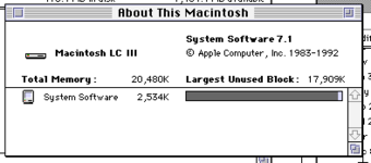

Here's what the About box should look like:

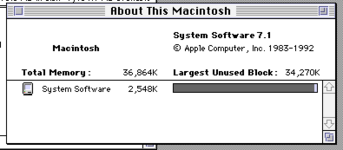

Here's what it looks like on the Performa 467. How sad. This Macintosh doesn't know it's name or what it looks like. This is the state that Apple in 1993 thought was acceptable.

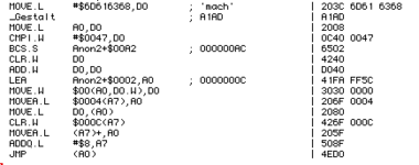

Now for the exciting part. 'lpch' 48 is different between the two enablers. It turns out to be a red herring, but it got me looking. 'lpch' 48 updates gestalt information. Notice the text 'micn' early in the resource below? That's the gestalt selector for the machine icon!
Some other interesting numbers are:
"0003" is the default icon when a machine is unknown.
"BF89" is -16503, which is the Macintosh LC icon.
"BD98" is -17000, which is the Macintosh icon for a known computer without an icon.
Here are the icons in the vanilla System 7.1 System file. ICN# -17000 is missing, which is why no icon shows on the Finder about box for newer computers. (Aside: System 8.1 includes a default -17000 icon.)
Now let's look at the code portion of the 'lpch'. It gets the 'mach' machine id. Then, it checks to make sure it is less than $47 (71) which is the length of the table. If it is too big, it just sets it to zero to get the first icon number (which happens to be 0003 to represent "unknown"). Otherwise, it doubles the id (because each icon number is two bytes long) and looks it up on the table.

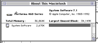

Therefore, if we count to the correct location in the table and change the icon for the LC III+ Performa 460 from "BD98" (-17000) to "BF89" (-16503) and reboot, we should get a proper icon. Ta da!

I think it looks like that since you are using an enabler meant for a Perfoma model that would have shipped with a "P" version of System 7.1, booting up my Performa 575 with its stock System 7.1P6 installed the About This Macintosh screen looks like this:
I *think* the previous "P" versions of 7.1 looked the same.
I do recall installing 7.5 when it came out and being super bummed to find the generic Macintosh icon in About This Macintosh. At the time I didn't realize they started that with the Performa versions of 7.1 (in slightly different way).
That is very interesting! You're right. I was using the enabler with a generic System 7.1 install. Your memory was accurate.
