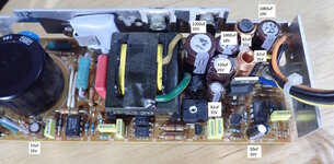

I've seen TDK, Aztec, and Dyna Corp power supplies in these computers. Because Dyna Corp (614-0028) is a little more unusual, here is the recapping layout:

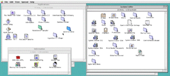

Although I imagine the original owner likely added and removed some of the Performa software bundle, here is a snapshot of what the drive contained when I got it. The "Information" folder with the Apple phone number and other help was novel to me.

Out of curiosity, is the system version on the hard drive 7.1P3? It sounds like that's the original version that shipped on the 467, and due to the absence of System Enabler 316, I would theorize that it's probably something earlier than 7.1P5.
All of the stuff in the Applications folder appears to be standard Performa bundle stuff. In 7.1P5, the HomeWorks Sampler folder is in Documents (but maybe the original owner moved it). The one thing I'm not 100% confident on is AOL -- in 7.1P5, the bundled AOL folder was named "Apple/AOL Performa 2.0.1a".
Yes, System 7.1P3
If I'm not mistaken, I believe 7.1P3 is a system version that is currently unpreserved. The restore disk that Apple Authorized Service Providers could have had for restoring these models to the original 7.1P3 version (Market Software Series Volume 1) hasn't been found yet. You might have some lost software on that drive!
