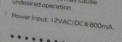

I have an AsanteTalk, which I recently (finally) picked up when visiting my 'folks in the US. It too had a 12VAC adapter, but being 120v only, I left it behind. I managed to find a UK 12VAC wall wart after a bit of eBay surfing - seems to be just fine.
A bit of Google'ing on the Mini EN/SC revealed this pic...
...and, specifically, this...
So... I believe yours will certainly be OK with 12VDC. I'll double-check mine, but I don't believe it had the "/DC" part...
