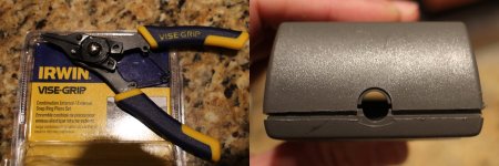

I opened one of these by drilling small holes and then used snap ring pliers, a small dental type pick, and a plastic pry bar. When the plastic wound't separate, I drilled another hole then scraped plastic out between the holes with the pick then separated with the pliers. Not pretty, a few gouges but not destroyed. I attempted a recap without success..its still not working, so I just used the cord on a toshiba power supply as described in a previous post. If you want the case, then message me...its about to end up in a box never to be seen again.
