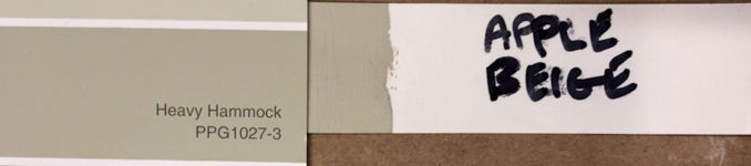

Pantone 453 is "Apple Beige," but keep in mind that age and exposure to sunlight will mean it's unlikely to match these days. You'll probably want to use 453 C because the plastic probably won't absorb any paint.
If you want a cheap, pre-mixed house brand paint you can pick up at the local hardware store, "Heavy Hammock" is exceptionally close.
Wow, Mr. Pigeon. That is great info. Thanks! I am looking to 3d print or otherwise find a box/case to put next to the Mac to hold Floppy Emu and Raspberry Pi, want it to all look matching. Much appreciated.
Ok, one correction. I think it was RAL 1000 that I used. Next week I could take a look at the can and tell you exactly.
