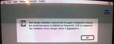

Everytime I power up the IIfx, I'm greeted with this dialogue box at the desktop:
Now I can access all of the contents on the ST-225N, and it seems to work perfectly fine considering its over 35+ years old. I never had this issue with it when I ran it with my Plus and SE, so I'm curious as to why the IIfx sees my 20MB ST-225N as a large volume that's over 4GB in storage. Is there anyway to fix this?

I had a similar issue last week with a 9GB drive. All partitions were ~1.7GB but my IIci wouldn't mount them and Drive Setup claimed something was bigger than 4GB (same dialogue). The cause was I formatted the disk in too newer machine / mac combo (9.1 on an 8600) and I couldn't overwrite the driver properly for some reason.
I solved it like this :
I formatted the drive using the Mac OS 7.5.3 Drive Setup. This would make the partitions mount and the drive show in the patched version of Apple HD SC Setup (critically the latter would not see the drive otherwise!) until I next restarted.
I then manually used the Partitioning section of Apple HD SC Setup to delete all partitions and drivers from the disk. Everything. Gone. Yes, shouldn't reformatting do this? No, it didn't have the same impact - it retained a secondary driver and a patches partition for the drivers unless I manually deleted them.
Next I used the top level "Initialize" button on Apple HD SC Setup to format the drive - warning! This took at least 45 minutes to format and verify! Leave it!
Then I used the partition button to delete the new main partition (leave the driver alone!) and create the partitions I wanted (I recommend keeping them just under 2GB).
If I remember correctly, on quitting I was prompted to name the first partition. On Restart, I was prompted to name the rest.
Took me all day to get it right 😆 . Quirks of old computers.:rolleyes:

I can’t recommend FWB Hard Disk Toolkit enough for formatting third party drives. Match its version up with the version of Mac OS you plan to run.
Make first partition only 10MB and make it not auto mount. Make second (boot) partition 1.9GB. Make other partitions whatever size you want. Works like a charm.
Also: recap at minimum the capacitor serving SCSI. Use a cap that is at least 25v at minimum. Apple underrated what they used and I’ve seen it myself twice blown.
Here’s the text from a post I made in 2020:
Boot from a disk that has System software on a 68k Mac. Use FWB Hard Disk Toolkit version 2.5 or 3.0.
Partition the drive as follows:
10MB Macintosh partition -set it to not auto mount. This is the partition that will hold your SCSI driver.
1.9GB (1900MB) Maximum second partition. Use it for your system folder.
1.9 GB third partition. This will show up as your second partition once booted.
Final partition for remaining size.
The SCSI manager on 68K Macs cannot handle drive sizes over 4GB without doing this, and cannot boot if the disk driver and system software are not contained in the first 2GB of the drive.
